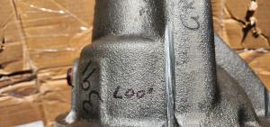

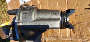

(10-23-23, 03:27 PM)Piper Wrote: First things first. I need to get it off of jack stands and make it roll again.
To do that I bought a 3.91 center chunk and axles from Dr. Diff
Is this one of those new case differentials? How does it look?
#12
It looks great, the center section looks a lot different to me. I've heard great things about it.
#13
It come with a Eaton sure grip or a Auburn?
#14
He calls it a Sure Trac, check it out.
https://www.doctordiff.com/8-3-4-helical...-trac.html

#16
(10-24-23, 11:49 AM)Piper Wrote: He calls it a Sure Trac, check it out.
it's the more modern Eaton unit... much strong than a clutch type Eaton or a Auburn... acts like a peg leg when driving normal, but when nail it, it engages.
Pretty slick

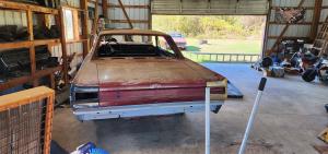

Some progress nothing to exciting other to document what I'm doing. Rear is in, need to get driver axle in
Notes for posterity: Center Section to Housing torque to 45 foot lbs and axle flanges 35 foot lbs.
#18
Rear is in and back on the ground for the first time in years
#19
Awesome! That has to be a good feeling
#20
Always a good feeling to get em back on the ground.
