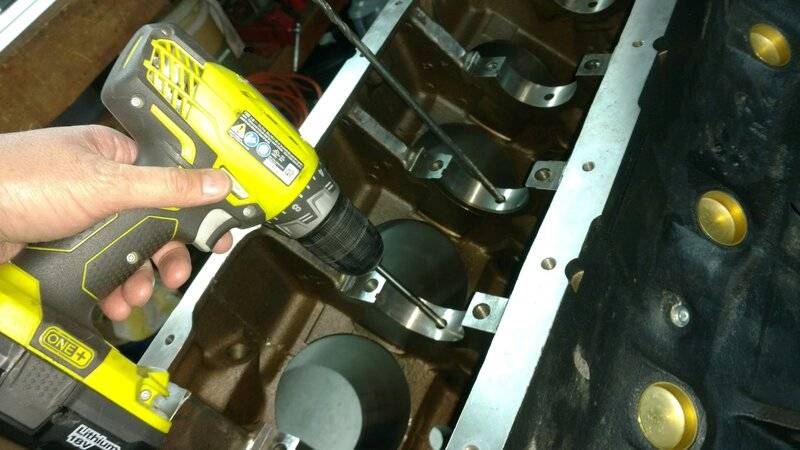

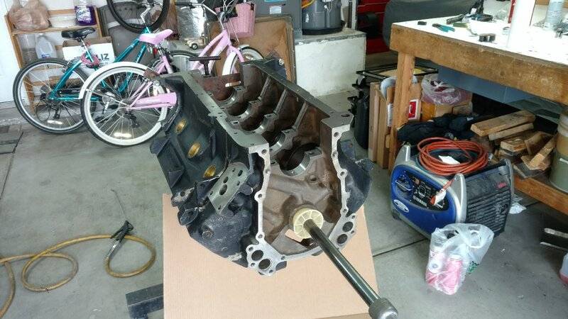

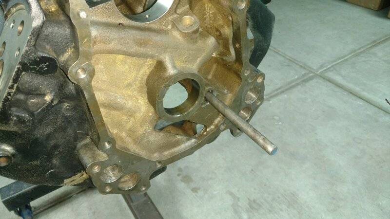

Update,

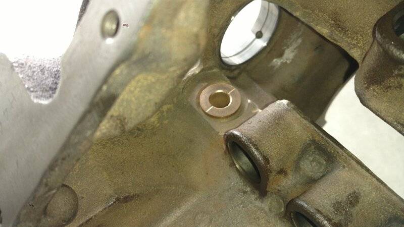

Originally I decided not to do any block oiling system modifications on this engine. I have now reconsidered, so I started reaming out the main oil feed passages (from lifter galley) to 9/32. I will also install a restrictor (drilled freeze plug) in the drivers side lifter galley as opposed to totally blocking it.
I inserted this steel 3/8 rod in the lifter galley to protect it from the reamer (just in case) turns out It wasn't needed and ended up causing the passages to clog up with iron shavings. You live and you learn I guess.

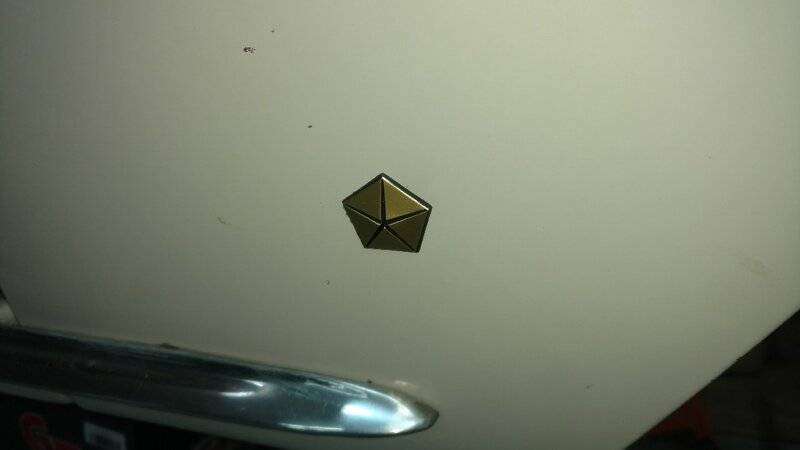

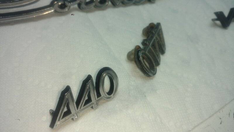

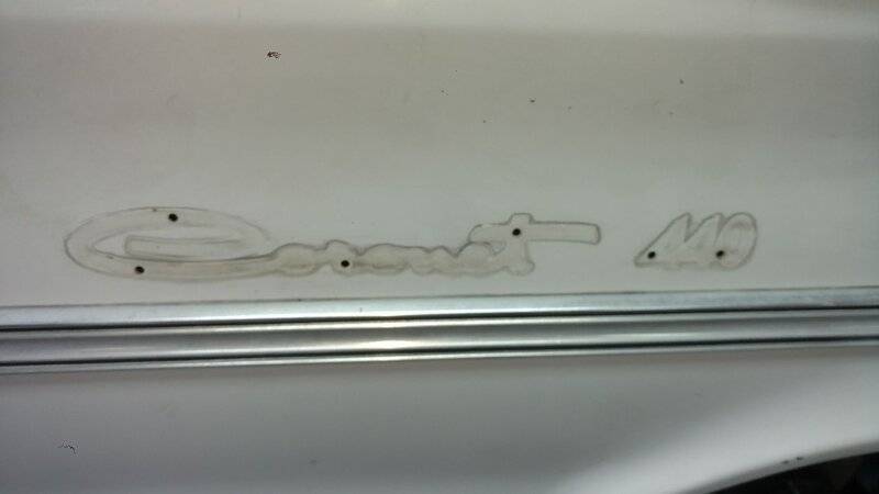

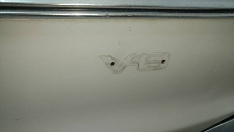

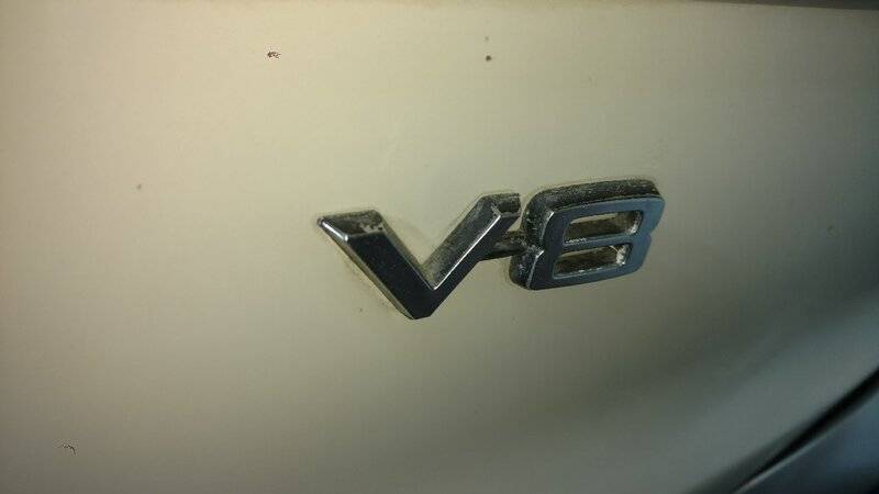

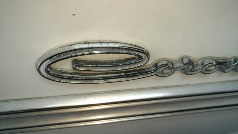

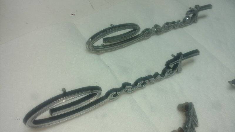

After the stains removed -
Here are the detailed emblems reinstalled - I was also able to shine up the side trim some. Not like new but much better than it was.

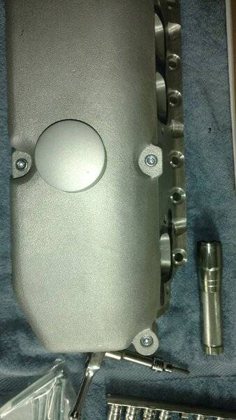

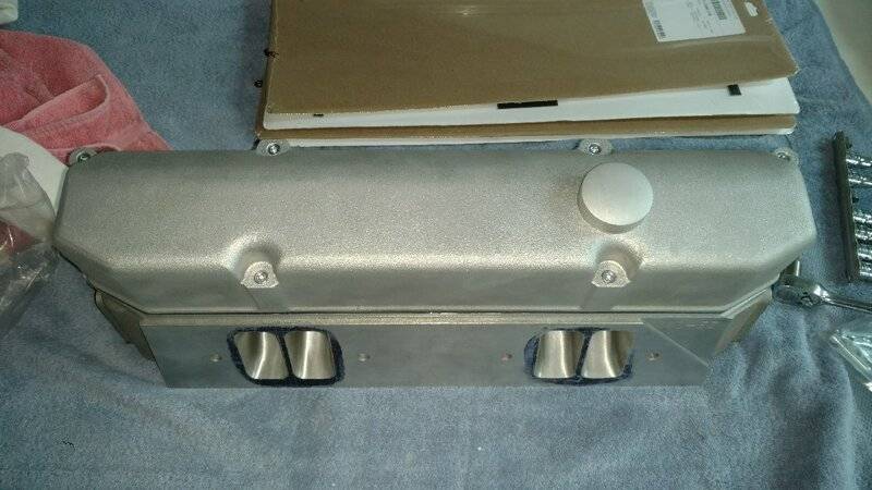

I also test fit my valve cover - perfect!

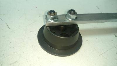

Update,
Assembly time, first I needed to make a tool to hold the belt drive cam adapter so the bolts can be tightened. It worked perfect
