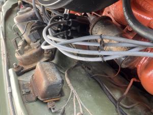

Finally back working on this after the cold weather. Swapped out points for pertronix ignitor 3 inside original distributor, and new flame thrower coil. I have not gotten it to fire up yet and wondering if I miswired something or did something wrong. This is my first time replacing points and upgrading the ignition.
I was told to take the ballast resistors out and did so replacing with a relay. I’m pretty sure I hooked the relay correctly but do I even need one?
Was I suppose to take out both resistors?

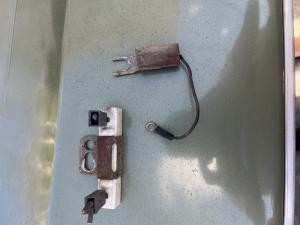

I’ll try to post a pic of what I removed.
Here’s what I removed
The smaller one was mounted beside the coil and the long one was on the firewall next to the ignition box
The smaller one is a capacitor, dunno why it was there, possibly a poor mans MSD setup? The white one is your ballast resistor.
The only reason for the ballast resistor is to reduce the voltage at the points to make them last longer. Cars without ones usually have them in the coil itself. Electronic ignitions will work with them, but the are not necessary.

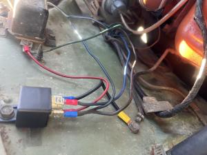

ok, so sounds like you’re saying neither one is necessary for my setup, which is what I understood to begin with. In place of the ballast, I have run a relay. I think I have the wires ran correctly, but would love to verify if I wired it right. Anyone have the wiring schematic for that ballast?
04-11-24, 03:49 PM (This post was last modified: 04-11-24, 03:50 PM by 67440Dodge.)
Hard to tell without seeing the pinout on the relay if it's right or not. Here's the schematic for the resistor. 2 wires in (blue and brown), 1 wire to coil (blue). Click on it to see it right side up.
Just curious, why running a relay? The coil doesn't get any voltage until the ignition switch is in the run or start position.

Thanks so much for the helpful info. I elected to use a relay after reading Pertronix suggestion to do so.
I was able to confirm that I had the correct wiring thanks to the diagram you provided. I still couldn’t understand why I could not get my car to start until I looked back over and realized I had the ignition wire on the negative terminal of the coil. Duh!
Now it’s running again.
