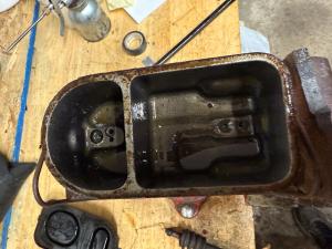

Took MC out drained it. While it looked clear at first, once I poured rest into pan, it was lot of rust stuff around.

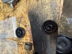

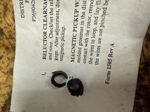

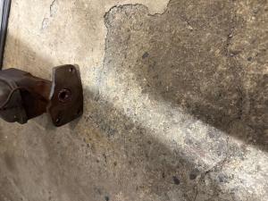

Tried to seperate the pushrod from the master cylinder..glad there wasn't a core on it..
Found out new MC's don't come with the pushrod bushing anymore.  Luckily Detroit Muscle had them and didn't rake me over coals for shipping

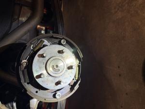

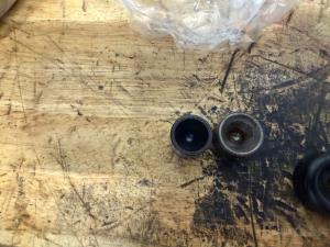

Backs were dry, but wasn't going to take chance. Bought some smaller bore wheel cylinders and put them in. Taking them out because the bleeder screws are metric and despite being a smaller WC overall, the screws were almost 2x longer than stock ones.
Still had firm pedal despite fact inner seals were leaking by.

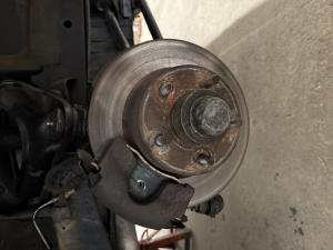

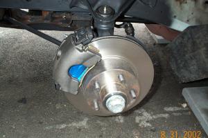

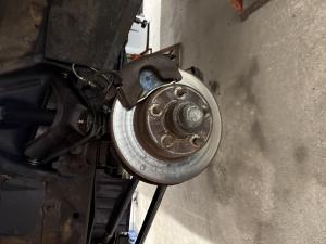

[Image: attachment.php?aid=9027]This rotor looks in really bad shape, or is it just the picture?
They are old like rest of system,  .. plus the pads are meant for a Diplomat police car so they grip pretty good.. they could be cut because they were from the era you could still cut them.
this what they looked like when I put them on Crusty Rusty in 02.. big improvement over the drums, esp since they had 2 deep grooves in them from rivets along with a matching set in the shoes

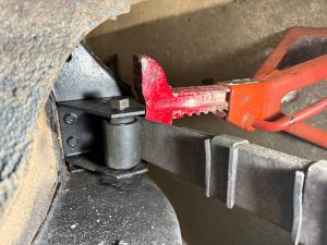

Mike,
Your spring bolt in installed bacwards. The bolt head should be on the frame rail side (for safety reasons)
Yup.. good eye.. had no choice at time.

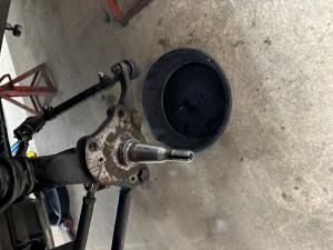

Finally got the correct inner race...  the bearing kit had the correct Timken bearing, but the race was smaller than should have been.  Here's what happens when anger management classes don't work..

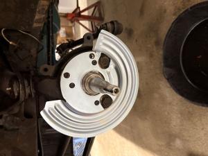

Original A-body spindles... even took the bent backing plates when I pulled them out of boneyard..
New backing plates

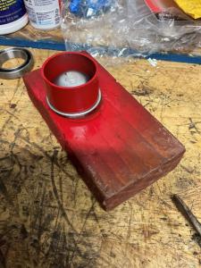

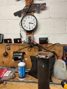

Tool made to get bearing cap to stay on as they are repops and slightly larger than stock, only way to get them to seat all evenly was to use this and a board with a hammer

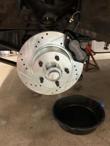

With 11.75 rotors and calipers.  Easy fit, didn't have to use any adjustment shims to get it even.

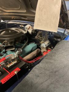

New small bore (15/16") master cylinder. Bendix discontinued them, Got it from Auto Zone, only other one that makes it now is Right Stuff unless went with the modern plastic fluid ones.

Did you use the Dr Diff adapter brackets to fit those Wilwood calipers?
(09-10-25, 12:32 PM)theman440 Wrote: Mike,
I actually bought the Stage 2 plus kit from him minus the spindles and master cylinder.  It was the most complete kit I've ever bought, even came with new washer/nut/lock/cotter pin/bearing cap.  Only thing I had to supply was brake fluid.
Went with his setup over a Wilwood one because if something happens to the rotors or bearings, I can go into any parts store and get one off the shelf
